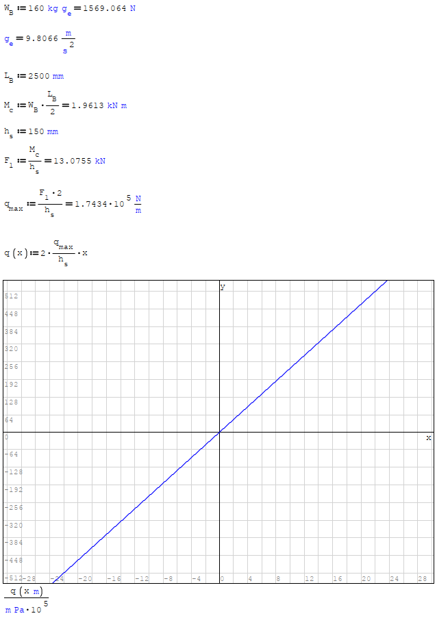

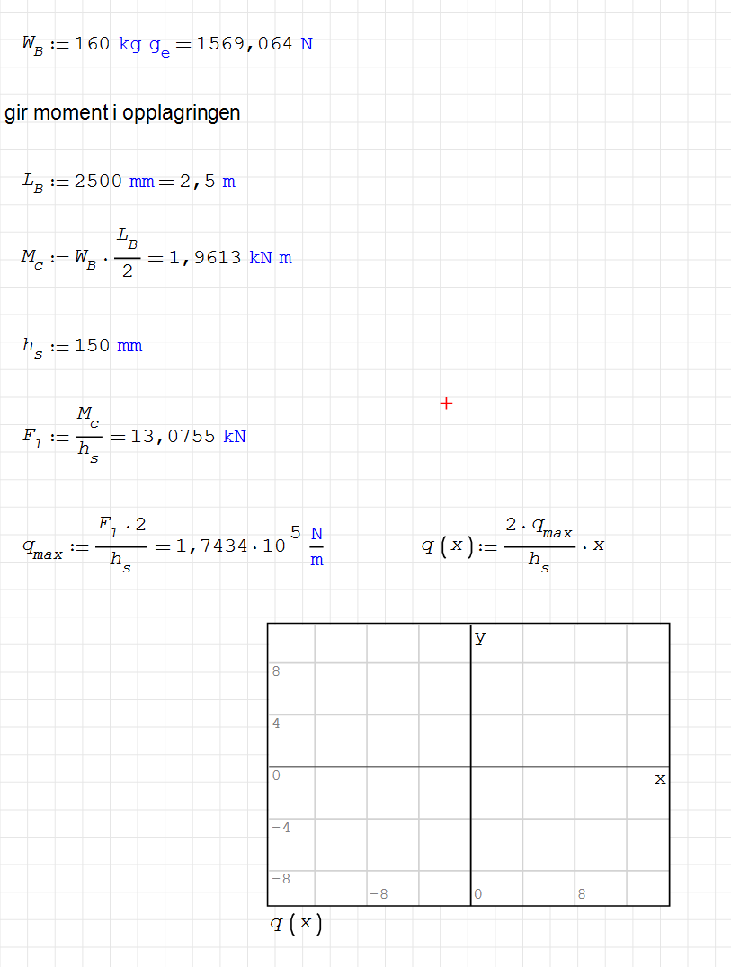

Sample_1.PNGI can't get this to work properly. I have tested with just a simple function using x as variable, and it works. This will not!

You are trying to plot with units.
I don't think it is possible or maybe I am wrong.
I could plot without units by the way.

It seems Smath can do plotting with units, just not my function from above. However, I am missing functionality on the 2D plot settings, adjusting the x-axis, y-axis etc.

Can you tell me exactly what you mean by this? I have tried plotting with m (meters) inside the function, but in my original function, it is not possible to plot with units...

I am simply trying to plot the function with N/m as unit, since I was able to plot with m as unit, I don't understand what the issue is.

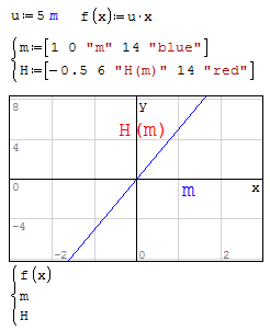

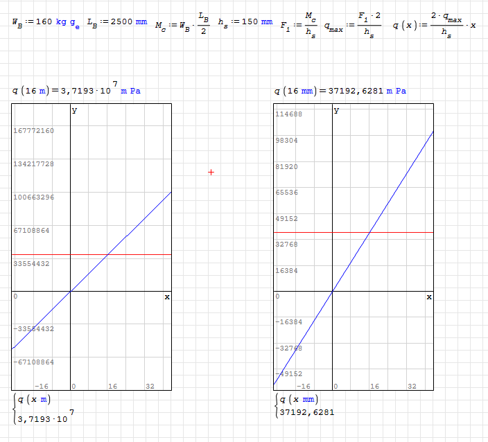

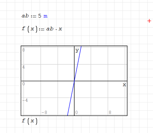

From a general point of view, you can plot functions with units:
  • by restoring "x" units in the input of the graph, since X-Y plot is going to place unitless scalars where "x" is.
    If your function expected an input with units, and since X-Y plot will feed that input without units, that's why you need to multiply "x" with that proper unit.
  • by dividing the complete function with the expected output unit of measure, since X-Y plot will only accept values without units on y-axis, while the original function to be plotted is going to generate results with units.
At least, that's how I depicted it in my mind to remember what to do.
Consistent units with different magnitude will consistently scale your "x" and "y" axis.

SMath is often able to plot with units, but you have to tell SMath the unit you are plotting along the x-axis (mm vs. cm vs. m), and you have to understand SMath plots the values along the y-axis in the SI units (that's the only way it knows how to).
In your case, you have to zoom far out on the y-axis to see the results.
What I usually do is what overlord did, dividing the function (within 2D plot) by the desired unit to force the results I want.
