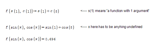

#2 Опубликовано: 07.07.2021 08:32:56
Yes it is possible, see the attached image

#3 Опубликовано: 07.07.2021 09:31:23
Paweł Wierzba
Paweł Wierzba
Thank you very much. Indeed, it works, even with functions with more arguments than one.

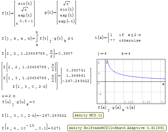

I had several functions and some coefficients to be calculated, based on them.
Something like the example below.
If done the standard way, it would involve a LOT of writing.

Hi. You can try a for loop with something like this in the body

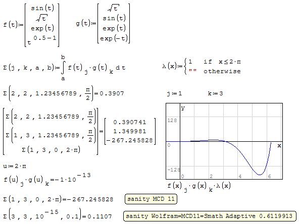

I posted the wrong image ... that's the right one.
Don't drop dead by how far simple integration can fly in the blue !

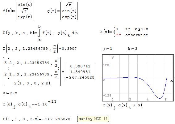

1. The previous image as *,sm
2. My Integration tool box.
Please, don't hesitate for + ... Jean
