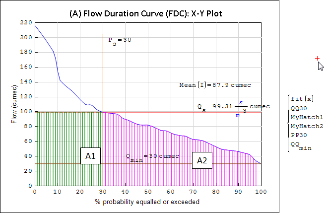

Thanks Andrey! With your Option 2, it works now with most of the problematic files, except the one which was attached.
I have to check it.
#4 Опубликовано: 07.01.2018 00:40:09
It works here 6179. There it seems it does not like units in cinterp
Your hatch seems damaged as well ... so sorry for the mess I did.
Hydro Power Estimation-Wilson Ex 6.11 fix.sm (229,23 КиБ) скачан 1405 раз(а).
You are correct. My file was damaged, but I don't know why.
Thank you.
