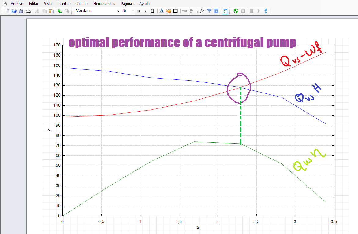

Hi guys
I was doing a simple exercise to find the sweet spot of a centrifugal pump and when I want to find the value of the intersection of two curves ... I have no idea how to do it.
also ... with that result of the intersection of the first curves I want to intersect another curve.
I tried "Linterp" and "Cinterp" but I was not successful.

Looks like a syntax problem only.
Q, H and WF are already in vector format, no need to place an additional vector "placeholder" inside cinterp.
See attachment.

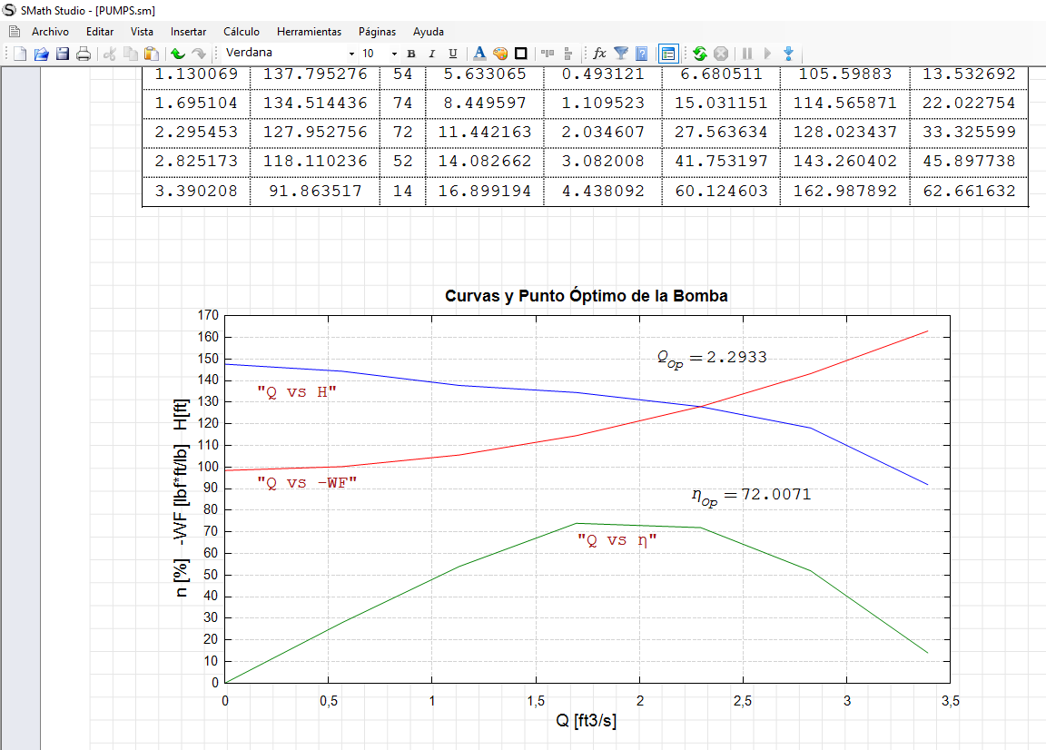

Thanks friend
I was very sad to see my error xD, it is like "it does not come out because you made a mistake in a + sign" lol
Here I leave the file with a little more detail, in case anyone is interested.
PUMPS.sm (626,92 КиБ) скачан 1061 раз(а).
