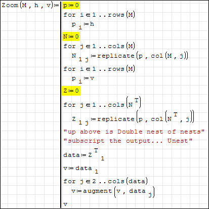

#4 Posted: 3/7/2016 9:16:30 PM
1,443 likes in 2,936 posts.
Hello Jean,
The error message of SS 5346 is strange, however in 0.98 is "Requested matrix element doesn't exist"; following the latest message the error is that in the function Zoom(M, h, v) you are using local unknowns as target of the assignments inside the loops; since you are in a programming-function, and p,N,Z are not defined before the loops, if in the canvas exists a variable with the same name, this variable is used in the function and the values locally replaced (or added if the target element is outside the original sizes). In your case the issue is triggered by Z (defined in the canvas in "Zoom integer").
You can avoid the issue placing Z:0 above the loop (or Z:matrix(rows,cols) with rows and cols as non-negative integers)

#5 Posted: 3/7/2016 10:25:37 PM
Thanks Davide, most appreciated.
I will implement as per your advice. In the mean while
finishing diner, the brilliant idea: decapsulate all
an everything, works fine and zoomed the "Persian Carpet".
