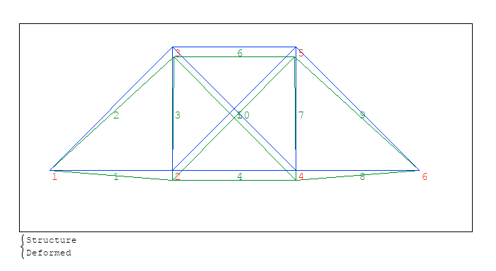

Hello I attach here a worksheet for the FEM analysis of 2D trusses, it has to be tested!

Here is FEMTRuss, my own version of truss calculus via FEM.
I'll check your work, please you check mine

So far results look good. Great work!

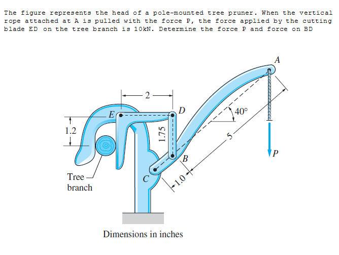

A little example solved by FEM...
P4-118 Pytel modified.sm (165.01 KiB) downloaded 1365 time(s).
