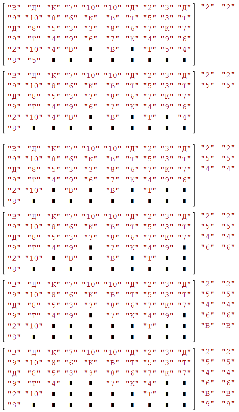

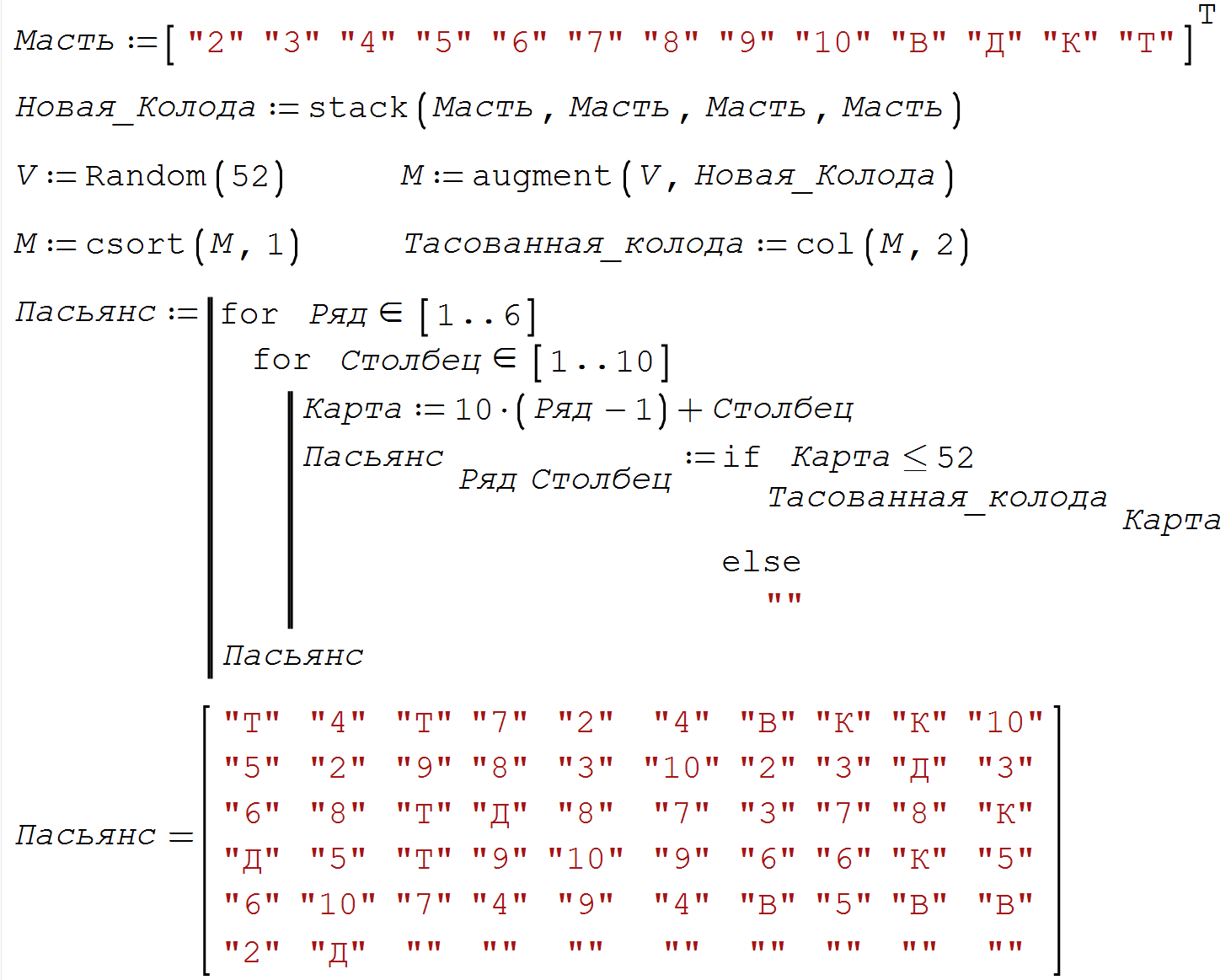

What is it with vector?
Patience.sm (37.01 KiB) downloaded 1415 time(s).

Sorry!
It is one strange bug, I think.
Without the program - all ok!
Patience.sm (37.01 KiB) downloaded 1405 time(s).

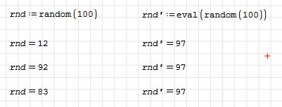

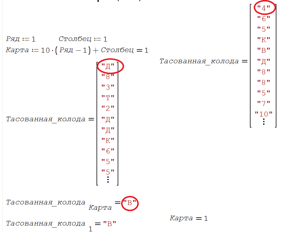

I wasn't able to reproduce the error, but it appears as if the Random() function is somehow redefining your variable every time you call "Тасованная_колода" to display.

Hi. It's not a bug, but a feature. Use eval to pin up the function value.
