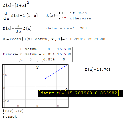

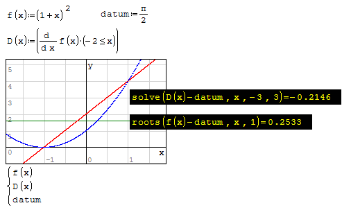

I have issues regarding diff function and boolean function.
I have been looking on different solution on the forum, but i have not found a related post.
How do you perform such calculation?
diff-issue.sm (19.92 KiB) downloaded 1392 time(s).
I mainly use Smath for simple calculation, and such boolean conditions, are used for Moment / shear load diagram etc...
(ps: I am not looking for a 10 digit precision, this is structural engineering
You will find in attachment a spreadsheet detailing the different test performed.
Thank you,
Pierre

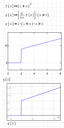

To obtain an answer, you are going to have to keep the boolean test out of your diff. equation.
Your equation would look similar to the following:

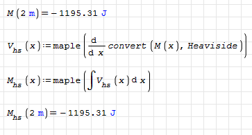

@Razonar
I was quite exited when i saw your answer.
However, i am not sur i use heaviside correctly.
It seems that the condition disapears after derivation.
You can see on the plot, that the calculation of both M and V are OK once the last heaviside condition is satified.
Do you have any idea on how to solve?
I dont mind using my actual methodology, but i would like to progress with smath
e7_5_3-hs.sm (135.14 KiB) downloaded 1408 time(s).
Pierre
Wrote... It seems that the condition disapears after derivation.
Hi. You're using Heaviside from Statical Tools plugin. I forgot it, because I don't use it, It define Heaviside(x,y) as (1+sign(x-y))/2, which could be cool for numerical procedures, but the derivative of maple of sign(x) is zero, but diff Heaviside(x) /dx is Dirac(x). So, the file that I upload works very different with that plugin. There are also other posts in this forum about Heaviside, Dirac and civil engineering. Maxima have their own implementation of those functions too.
WroteHello everybody,
diff() function can't parse if original function has boolean expression.
Once derivative is completed result can be booleaned. (is this even a proper word
Here how it is.
Wrote...
Yes. Use maple(diff(convert(M(x),Heaviside),x)) for convert SMath sign function into Maple Heaviside's. It looks ok now:
e7_5_3-hs ok.sm (139.5 KiB) downloaded 1426 time(s).
The evaluation at 2m (ie:78in) is higher than the higher boolean/heaviside condition, therefore the result is always ok.
In My comuter the graph of shear (V) clearly showes an difference between V and V.hs below 45inch, is it similar for you?

WroteDear alvaro
Hi. Yes, but I just don't pay attention to the "small values" at inches, just see that both are the same at meters. Some notes about Heaviside in the attached.
