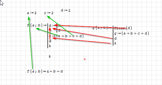

#4 Posted: 11/13/2024 2:39:13 AM
Hi Davide,
Thanks for your comments and for “provoking” me to pay more attention to the subject.
I followed, and I agreed with your arguments.

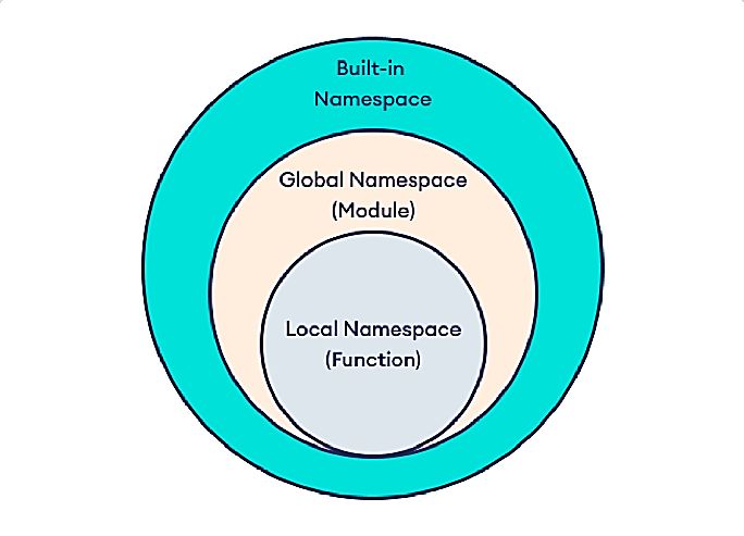

My first impression is that the problem of how SMath handles the “Variables Namespaces and Scope” is insufficiently documented. And hence derives some folklore, followed by a practice based on aping each other’s’ examples and practices (eg.- by decorating the names inside functions..). I include myself in this area of followers.
Of course, my proposal for the creation of a special user’s function, totally encapsulated, communicating read-only in the explicit input and output place, IMHO, could avoid totally and simply uncontrolled interferences.
I’m only approximately informed about the C# programming and management of the variable’s scope. I tried to understand how the subject is solved in Python language.
https://www.programiz.com/python-programming/namespace
Here is a synthesis of their vision:
Here there are some explanations about their strategy:
https://realpython.com/python-scope-legb-rule/
This is LEGB rule:
LEGB stand for Local, Enclosing, Global, and Built-in scopes.
• Local (or function) scope is the code block or body of any Python function or lambda expression. This Python scope contains the names that you define inside the function. These names will only be visible from the code of the function. It’s created at function call, not at function definition, so you’ll have as many different local scopes as function calls. This is true even if you call the same function multiple times, or recursively. Each call will result in a new local scope being created.
• Global (or module) scope is the top-most scope in a Python program, script, or module. This Python scope contains all of the names that you define at the top level of a program or a module. Names in this Python scope are visible from everywhere in your code.
• Built-in scope is a special Python scope that’s created or loaded whenever you run a script or open an interactive session. This scope contains names such as keywords, functions, exceptions, and other attributes that are built into Python. Names in this Python scope are also available from everywhere in your code. It’s automatically loaded by Python when you run a program or script.
The local scope or function scope is a Python scope created at function calls. Every time you call a function, you’re also creating a new local scope. On the other hand, you can think of each def statement and lambda expression as a blueprint for new local scopes. These local scopes will come into existence whenever you call the function at hand.
By default, parameters and names that you assign inside a function exist only within the function or local scope associated with the function call. When the function returns, the local scope is destroyed and the names are forgotten.”
It seems that you mean that by using “Clear Function” it could fully force the local scope into an implicit declaration?

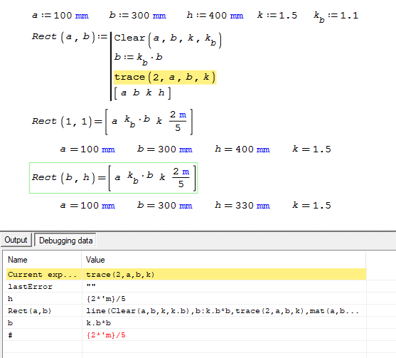

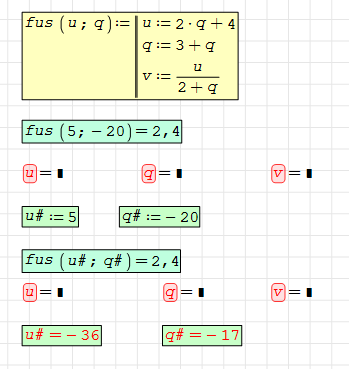

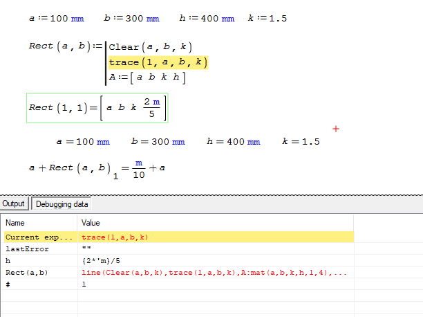

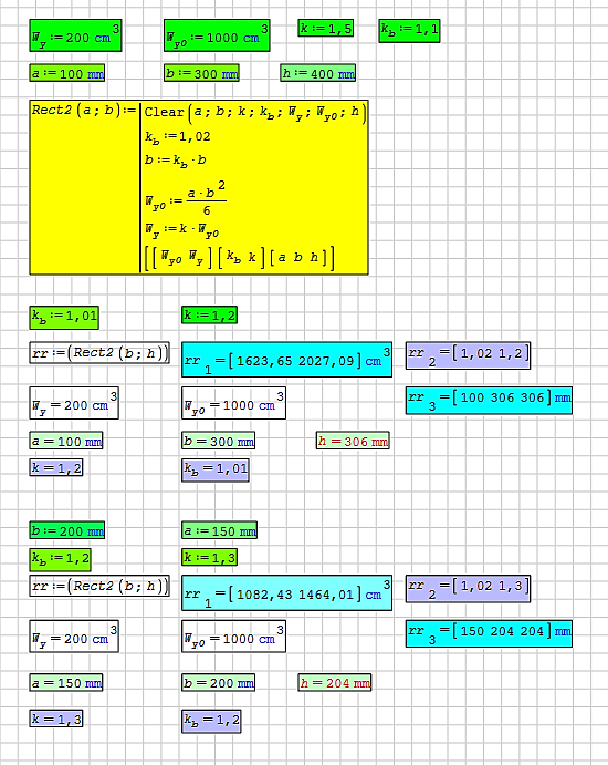

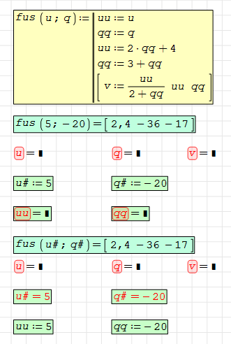

For a better assessment of the subject, I imagined some simple exercises:
Scope-Ioan.sm (57.48 KiB) downloaded 1615 time(s).
These examples show some simple sources "to build the hell".

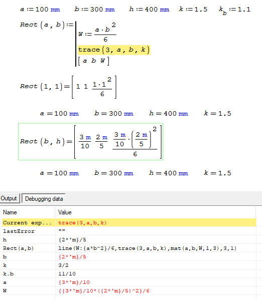

10. For instance, in my post #4, there is this example:
That drives me nervous. Why the “h” variable was modified; I had never modified it inside the function??? It seems that variables are manipulated “By Reference” and not “By Value”??? Inside the function, I cleared all, including the function’s parameters (as Davide suggested). Of course, the example is a little bit twisted.
11. In the context I keep my opinion that, by the simple introduction of a kind of special user’s function, totally encapsulated, all my problems will be vanished, without attempting the other’s happiness built on using things as they are now. That’s my true and maybe only problem on which I expect some positioning. Of course, I do not pretend as being right, but I expect arguments and especially solutions.

#9 Posted: 11/24/2024 10:16:29 PM
I don't think there is a provocation; the program lacks documentation and there are hidden features that might be forgotten or overlap easily.
I have still this around, but seems it is outdated in some parts, since some changes were made along the road: User-defined Functions in SMath Studio (rev.8).sm (293.72 KiB) downloaded 1783 time(s).
Your example has several things inside it, looking by small bits.
I also think a different sealed function would be a good tool to have. About Kenny's layers I understand it, but probably anything "above the canvas" could be safely considered a "superglobal" by the users, and therefore by such sealed function.
- Clear(...)
here you are clearing all variable names. Since a and b are variables passed by the function on the LHS, these are cleared as well. This means all calculations involving these variables are made simbolically.![2024-11-24 15_57_16-SMath Solver - [rect.sm_].png](/en-US/files/Download/825ncV/2024-11-24-15_57_16-SMath-Solver---[rect.sm_].png)
As you can see (now) the result doesn't replace the local variables because SMath recognize that the local a is not the global a (previously it would have been replaced by the global a value once exposed to the canvas). - b:k.b*b
That's not as straightforward as before, but with line() you can pass back variables to the canvas (as official feature, there is some post by Andrey somewhere); if you redefine a LHS variable name inside the line(), this change will be passed back to the canvas, using the input name canvas side.![2024-11-24 15_40_13-SMath Solver - [User-defined Functions in SMath Studio [rev.8].sm].png](/en-US/files/Download/wQHBgs/2024-11-24-15_40_13-SMath-Solver---[User-defined-Functions-in-SMath-Studio-[rev.8].sm].png)
Here it seems the Clear() effect doesn't apply neither on the direct call (e.g. Clear(a,b) has not cleared the inputs b and h) nor in the redefinition (global_h after the function call is not exposed_local_k.b*exposed_local_b but is global_k.b*global_b).![2024-11-24 16_00_55-SMath Solver - [rect.sm].png](/en-US/files/Download/HNKLL2/2024-11-24-16_00_55-SMath-Solver---[rect.sm].png)
Clear() behaviour aside, the point is that inside line() you shouldn't redefine a variable passed as argument by the LHS function.
I think is also bad as practice, since k.b*b it should have another name (b',b*,...) since is another parameter (but I understand the frustration). - twist in variable names (global vs local); this seems it is handled correctly (this is what introduced the change in exposed_local vs global observed in the first point above).

#10 Posted: 11/24/2024 11:57:07 PM
Thanks for answering my “non-provocation”. Thanks for your attention and for your patience, commonly respected in this forum.
I have no doubt that, behind SMath operations, there is some logic, potentially accessible to even ordinary users like me. I recognize that it’s hard enough for me to follow totally the nice debugging process you developed. However, I think it is a thousand times better to be able to get rid of this type of situation due to the existence of more robust programming rules ( ?!).
Such a simple partial solution could be the creation of a new type of user function, completely sealed, like the trigonometric functions of the system. I understand that you also agree with this proposal.
Of course, my example is deliberately provocative, but it also shows how one can "build a calvary in a hospital".
If, for every use, we must consider a debugging operation like yours, I fear that there rests no longer a great attraction to this software.

#11 Posted: 11/25/2024 5:16:54 AM
If you highlight a variable inside a line block and press F12, then the cursor jumps to where the value is defined
1. if then the cursor jumps to the parameter list on the left hand side of the function definition, this reminds you that it is a parameter of the function
2. if the cursor remains where it is, then it it is a reference to an undefined global
3. if the cursor jumps to somewhere inside the function, then it is a true local variable.
4. if the cursor jumps to somewhere outside the function, then it is a defined global variable, yet the value is ignored at storage time, as can be seen from the preview of the stored expression. This is actually the same result as in case 2
Clear() is ignored by this mechanism. I.e. if you have a local Clear, this should be the jump target.
Also, if you use the name of a local variable of a definition on the canvas outside, F12 jumps to the definition of that variable inside the function definition. That is definitely not correct if whatever you define inside the function is local (unless it is in the parameter list).
Here are some examples of F12 jumps. Those which I understand are in green, those which not, are in red. In f(a,b ) I actually use the long standing Clear() trick by Davide, which actually seems to be more reliable than the new built-in version. Yet it is over-greedy, as it deletes d also in the global scope, which should not happen by a definition inside a line block function.
![2024-11-24 23_25_12-SMath Solver - [TM2 09 04.sm_].png](/en-US/files/Download/GpVEq6/2024-11-24-23_25_12-SMath-Solver---[TM2-09-04.sm_].png)
Would perhaps helpful if the various situations could be marked by coloring the variables. All variables that could be taken from the outside could be in red.
All variables from the paramter list could be in blue.

#12 Posted: 11/26/2024 4:29:42 PM
Hi Davide, Martin and Kenny,
All my gratitude for reviewing some aspects of the specific SMath Debugging Process.
Almost all programming languages include debugging procedures. SMath, owing a high transparence and friendly design process, is naturally less indebted to an eventual debugging process. A special case is inside functions.
As about trace() using practice, in the case of a complex application, things are not more so easy. IMHO, an excessive use of debugging risks to kill the major SMath’s singularity – that of simplicity and transparency.
It appears that the very basics of SMath are poorly documented and also not enough retrieved in the Forum. I feel it as a major weakness and a mission to be accomplished.
Looking around some present exchanges, I feel stimulated to observe my naïve use of variables, far from SMath’s native assumptions.
Synthetically, if I’m not wrong, we can say that any variable used on canvas, outside user functions, behaves as global (accessible allover in read/write; including modifiable, with consequences overall in its instances - local or global) over the entire application (including inside user functions).
On the contrarily, inside any function body, all variables which aren’t already used as global (this is identical as being explicitly declared) are only local, without diffusing values into the main application, nor into other users’ functions.
Davide, Martin and Kenny, please correct my assertions if necessarily.
In this context, it appears to me as more logical (?) to “decorate” only the global variable names; this also leads to the idea of using as few as possible global variables (provided, if necessarily, as a precaution, with “decorated” names, instead of an explicit scope declaration).
The local names used inside user functions keep totally the feature of being “sealed” (valid only inside the function) with a full independence of variable content in each function, as long as they do not become “global”. I’m not very sure if a variable used as a function return becomes so “global” (as if declared, “By Reference”)???
A special case is of the applications without user functions. Here the "decorations" are not indicated; all variables are as global.
If what I’ve said here is true and clearly explained to users, there is no more reason to modify the core program.
However, I maintain my proposal on the utility of the creation of a special kind of user function, totally encapsulated.
I wait for some critical reactions and especially proposals about my observations.
PS:
This example shows that if the parameters of a function are modified inside the function, the global values of parameters will be changed:
what can complicate the use.
That's a suplementarily reason for the use of an encapsulated type of function.

Thanks for the return.
I agree your observations.
I extended a little my example:
1. I understood that the names in the call line are global names.
2. I copied the input variables as local names, inside the function.
3. Without being alterated inside the function, the input names values seems saved against inner uses.
This seems good news (!?)
4. The input variables copy rest invisibles outside the function.
5. As a principle, any global variable is totally accessible (read/wrote) in all the functions existing on the canvas. Therefor my proposals to give "decorated" names to global variables.
However I'd prefer the special encapsulated function. This leads to less precautions.
Allover, it seems that some strategies are available, once the user is advertised on the basics.
