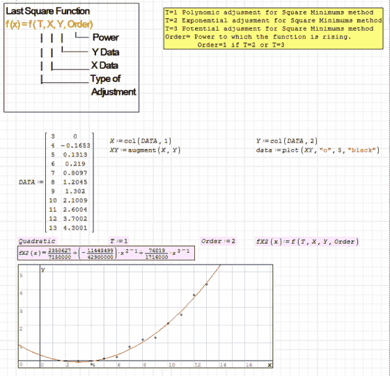

#1 Posted: 4/26/2019 12:06:13 AM
Another example of curve fitting by the least squares method
with option to select the power of the polynomial, or
select the adjustment of the curve to exponential or potential.
Ajust_by_Last_Square_Selection_Jean.sm (56.61 KiB) downloaded 1219 time(s).
Carlos
Carlos
5 users liked this post

#2 Posted: 4/26/2019 10:40:32 AM
WroteAnother example of curve fitting by the least squares method
Hola Carlos !
Couldn't open the attached SS 7030 work sheet.
It happened another time from maybe Alvaro ?
Seemingly caused by 2 of your modules not activated.
My SS 6179 does not closed those two particular modules.
However, I have recognized the flat parabola data set.
I'm sure your proposal will have more applications.
Data sets with flat region best fit by model function,
like this one from al_nleqsolve, always assumed noisy.
Two flat parabolas attached
Thanks... Cheers ... Jean
Genfit [Algo Minimize(Cholesky_3 NonLinear)].sm (37.14 KiB) downloaded 968 time(s).
Genfit al_ nleqsolve [Edu Model FLAT Parabola].sm (30.24 KiB) downloaded 952 time(s).
#3 Posted: 4/26/2019 2:18:39 PM
Hola Carlos !
Hola Jean
Here you have a version in 6179 of the work sheet
of the method of adjustment of curves by least squares
Ajust_by_Last_Square_Selection_Jean_V6179.sm (52.77 KiB) downloaded 1242 time(s).
Cheers
Carlos
