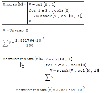

#7 Posted: 3/5/2016 8:55:35 PM
Ioan,
You can dedicate a function "VectorMatrixSum(data)"
Unwrap has many more applications, thus interesting.
Under the hood, your combined Sigmas, they first
Unwrap. Matrices don't exist in computing Machinery.
Matrices exist as serialised components.
The "BombCompute Mathcad 11", copy/paste a fair size
matrix [16000000 per say] takes substantial time.
"Warning: the requested operation may take long time".
Can't be more true.
Cppy/paste 16000000 vector: NO warning message... done.
Chers, Jean
