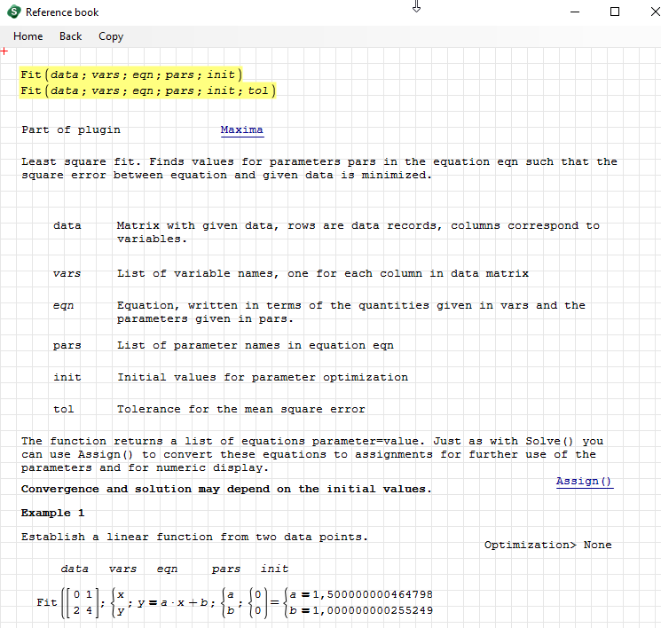

#7 Posted: 1/14/2022 5:36:56 AM
1,356 likes in 2,271 posts.
Is there any curve fitting function in Smath?
I mean using the defined points to find the function of these points!
Thanks a lot!
Maxima plugin has the Fit() function, see this post
In the interactive handbook, you find it in the Function Index page.
sergio 1/14/2022 6:15:00 AM
