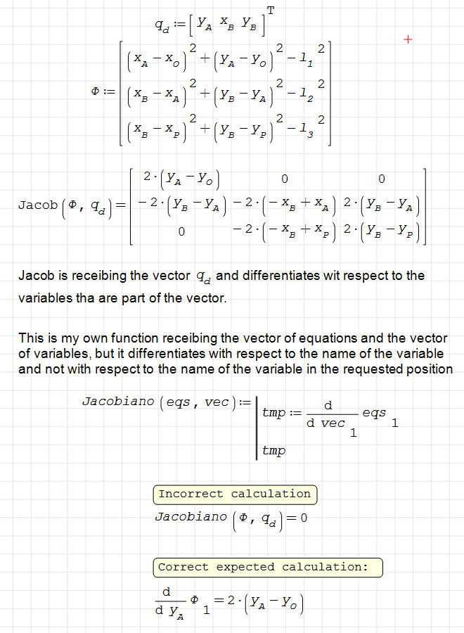

Dear all:
Dear Friends:
I'm relatively new to Smath and I have a question that I've been trying to solve for a long time and I can't find a way.
This is to use the "diff" function to differentiate an expression with respect to the variable that is an element of a vector, just like the "Jacob" function does. Here is an example:
Hope you can help me and tell me how to derive a expression with respect to the correct varible name.
Best wishes to all,
Mario

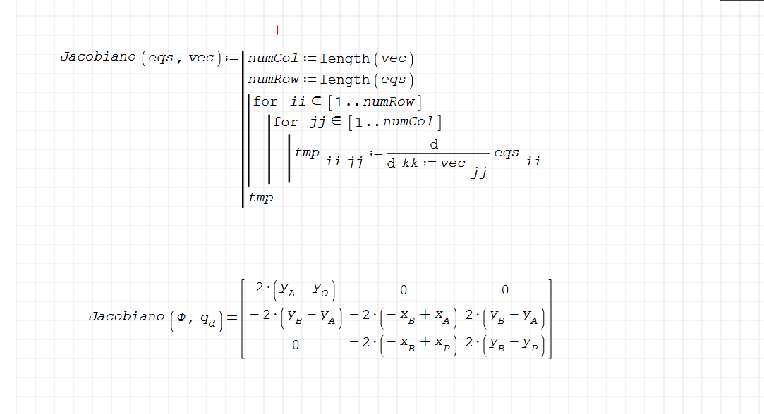

I could not tell you why this works.. but assigning another variable the value of q.d[i seems to work.
Jacobiano.sm (8.76 KiB) downloaded 1228 time(s).

I could not tell you why this works.. but assigning another variable the value of q.d[I] seems to work.
Thank you very much!, it works fine. I am also wandering why, but it works!
