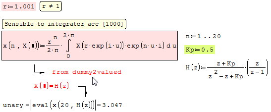

#1 Posted: 12/10/2018 1:39:00 PM
Can't manage this otherwise than shitting bricks !
Solution is welcomed ... Thanks
Done otherwise to rescue the Document.
Inst_PID Discrete Schema EXAMPLE_6 Failed.sm (36.61 KiB) downloaded 1271 time(s).

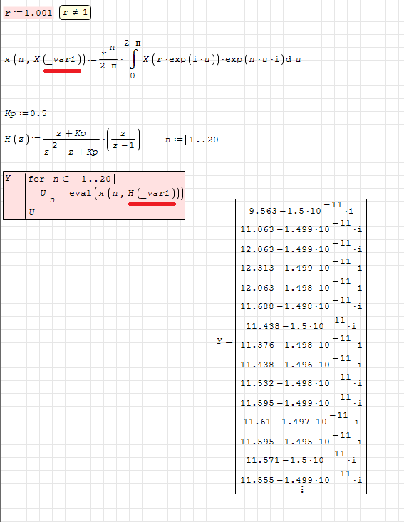

#3 Posted: 12/10/2018 3:55:07 PM
WroteCan't manage this otherwise than shitting bricks !
In order to pass functions as inputs to other functions you need to declare it as such and pass a "dummy" variable. See following.
There is still a problem in that it is not evaluating properly, I believe.
Inst_PID Discrete Schema EXAMPLE_6_Partlyfixed..sm (44.75 KiB) downloaded 1264 time(s).
frapuano 12/10/2018 4:55:00 PM

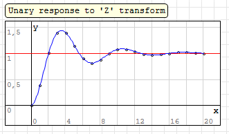

#4 Posted: 12/10/2018 8:29:36 PM
fixed
Inst_PID Discrete Schema EXAMPLE_6 - fixed.sm (46.19 KiB) downloaded 1293 time(s).
![2018-12-11 00_34_33-SMath Studio - [Inst_PID Discrete Schema EXAMPLE_6 - fixed.sm].png](/en-US/files/Download/xLgXx6/2018-12-11-00_34_33-SMath-Studio---[Inst_PID-Discrete-Schema-EXAMPLE_6---fixed.sm].png)

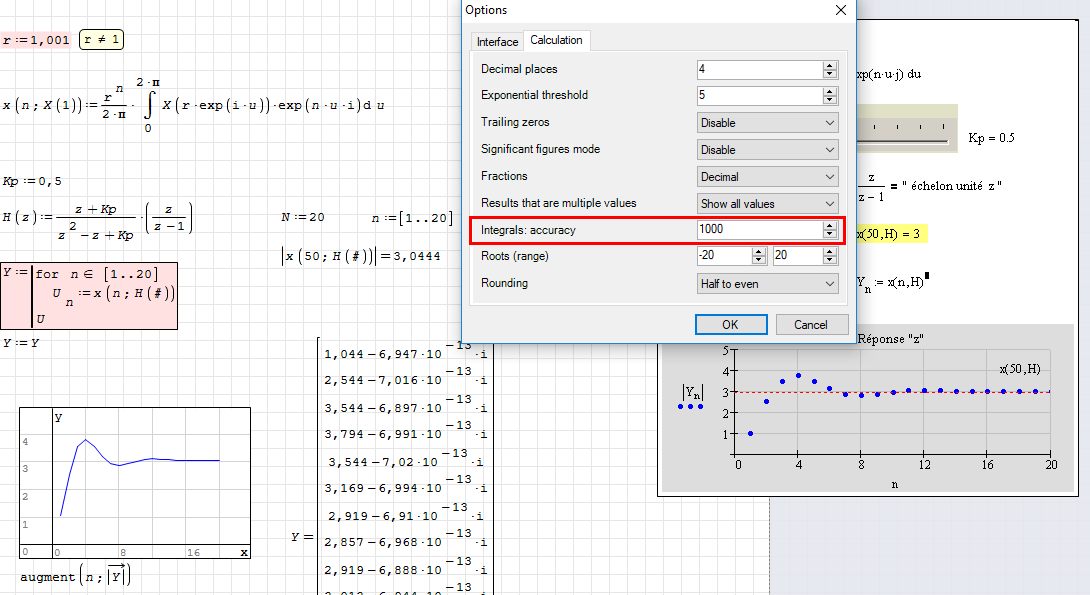

P.S. To obtain similar results, change the integration accuracy to something higher than 100
![2018-12-11 00_53_52-SMath Studio - [Inst_PID Discrete Schema EXAMPLE_6 - fixed.sm_].png](/en-US/files/Download/pwH7T5/2018-12-11-00_53_52-SMath-Studio---[Inst_PID-Discrete-Schema-EXAMPLE_6---fixed.sm_].png)

- removed answer requested for first argument of the last system;
- used f(number_of_arguments) function of function argument (more elegant, point out that the variable name doesn't matter);

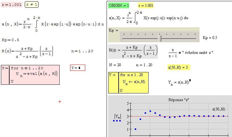

#5 Posted: 12/10/2018 11:05:36 PM
Wrotefixed
Dumb question maybe, but how do you get the '#' to show up in the H(#) function call?
#6 Posted: 12/11/2018 12:50:47 AM
WroteDumb question maybe, but how do you get the '#' to show up in the H(#) function call?
As simple as that: x(n,X(▄)) ... simply the native dummy argument
big square imitation Alt220 ... try it.

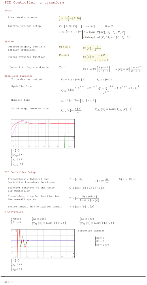

#9 Posted: 12/13/2018 7:02:18 PM
Hi. This is the setup for use inverse laplace transform for numerically evaluate the response for a system in z domain.
pid_controler z.sm (50 KiB) downloaded 1271 time(s).
