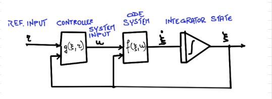

A general purpose, simple ODE solver function that uses Euler integration to simulate (possibly non-linear) multi-inputs dynamic systems, with "embedded" provision for state feedback controller.
In its most general form, the function implements a system of the form:
where dot notation indicates time derivative.
