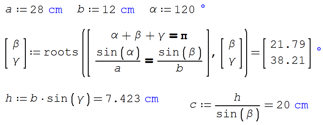

SMath Forum SMath Studio Questions Roots&Units 1 Pages (4 items) Roots&Units - Messages Go to last post #1 Posted: 9/7/2024 1:25:15 PM Valery Ochkov 66 likes in 691 posts. Group: User Do you know more simple method?Natasha-Units.sm (147.18 KiB) downloaded 1485 time(s). #2 Posted: 9/7/2024 2:51:40 PM overlord 598 likes in 1,380 posts. Group: Moderator FindRoot() can be a simpler method.You can auto assign guesses to unknowns.And it can solve with units.RegardsNatasha-Units_findroot.sm (114.03 KiB) downloaded 1490 time(s). 1 users liked this postValery Ochkov 9/7/2024 6:25:00 PM #3 Posted: 9/8/2024 8:49:53 PM StvMath 44 likes and 1 dislikes in 71 posts. Group: User Here's a simple method: 1 users liked this postValery Ochkov 9/8/2024 8:59:00 PM #4 Posted: 9/9/2024 12:22:30 AM Valery Ochkov 66 likes in 691 posts. Group: User 1 Pages (4 items) New Posts No New Posts
