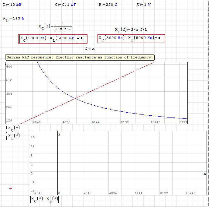

I am getting the following:

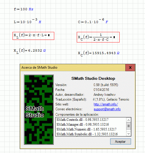

Depending which version, it could be. I guess that must to be an election from author, this is, if eval functions in that way. The "not evaluation" option, as the attached picture, it's ok for me.

i am using

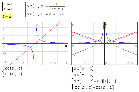

Just like this Basile, for a family of "C's"
at a fixed frequency 8 the magenta line.
On the plot, 'f' => 'x'.

Yes, I can plot X.C(f) and X.L(f) but if I try to plot the difference or take the aritmetic difference does not work.
Please see figure and figure in post #1 on top, if it helps.

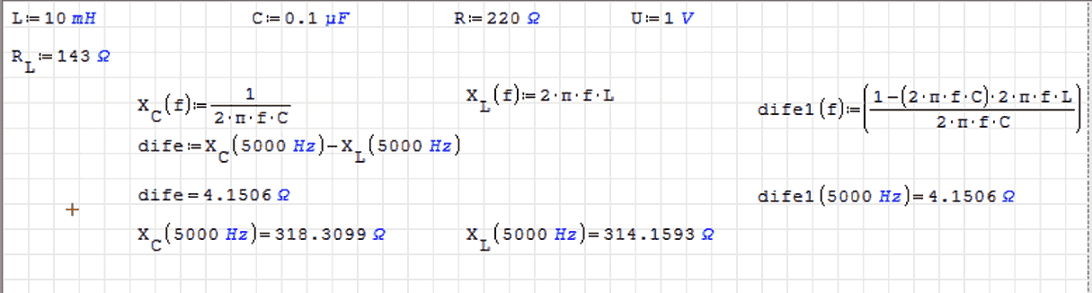

Redefining subtraction or function.
Carlos
test resonance_CBG.sm (10.1 KiB) downloaded 992 time(s).
