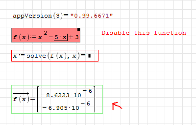

#1 Posted: 7/8/2018 3:38:09 AM
Try to reproduce this, please.
This is the attached file bug.sm (4.41 KiB) downloaded 1363 time(s).
Now, disable the function definition
f(x) vectorized will get stuck.

I think Radovan just wanted to indicate a malfunction when the function is disabled and the subsequent vectorization on the function goes into an infinite loop.
I think he was expecting a non-evaluation (I was expecting it too)

I'll have to get back to my first post
Function f(x) was not defined. What is going on then? Why the calculation did not stop with an error issued? If you wait enough it can crash SMath. I reproduced that on few computers and suspect this might be a bug or a problem. That was my question.
#10 Posted: 7/9/2018 10:31:49 AM
For sure, if you wait too long before [Shift+Esc] it will crash Smath,
because it enters an infinite loop. That answers your question ! bug !
When entering an infinite loop there should be an error message/stop calculate.
