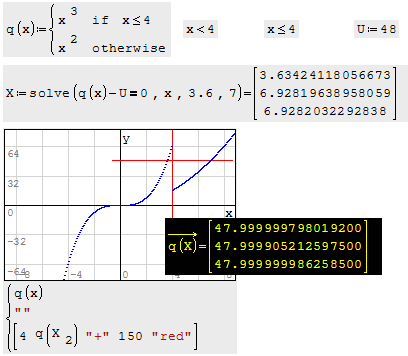

Update of statement:
solve(), roots(), FindRoot() doesn't like if() function.
However, they can solve when cases() used instead of if().

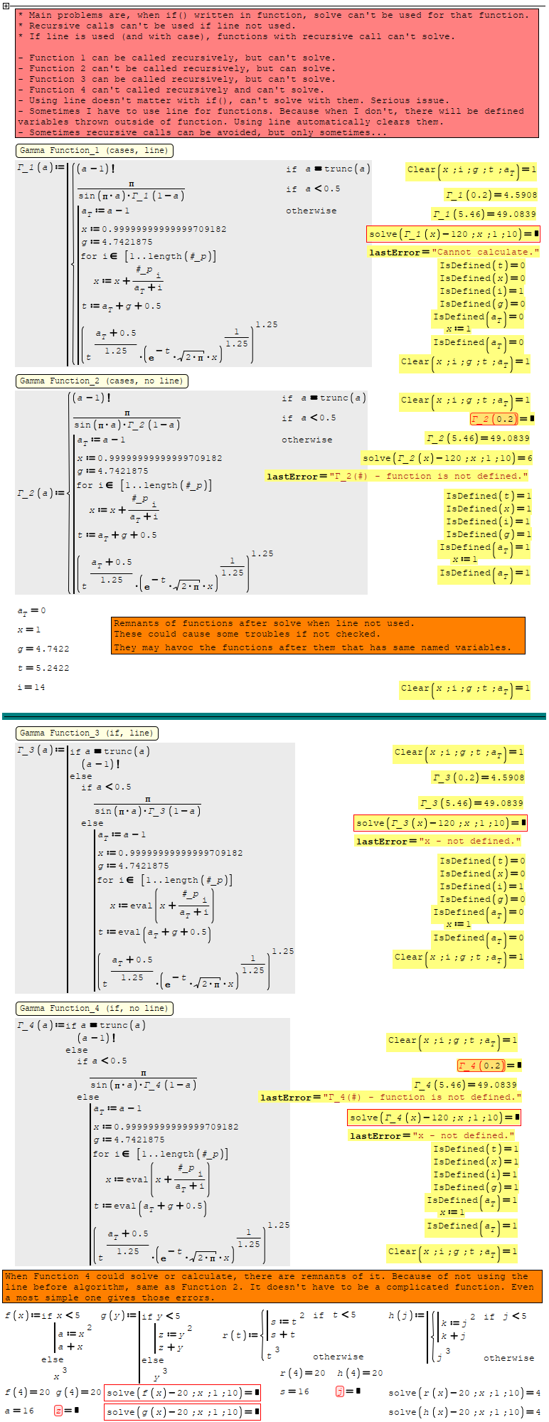

I have diagnosed the symptoms with solve bug.
Made a page about this and tried to explain with detail.
somebugs.sm (54.72 KiB) downloaded 1600 time(s).
somebugs.pdf (522.2 KiB) downloaded 848 time(s).
Andrey Ivashov 6/11/2021 4:06:00 AM, NDTM Amarasekera 6/11/2021 10:44:00 PM

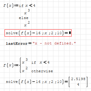

solve(), roots(), FindRoot() doesn't like if statement.
if/else was reported SS 5346.
Davide added if/otherwise SS 6179
