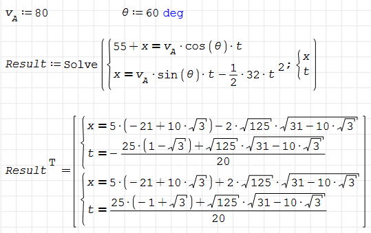

Good afternoon everyone.
I'm using the "roots" command, but I'm not getting the two points where the line intersects the parabola. The command gives me only one result and omits the other point. Attached is the file and image of the problem. How can I find both intersection points?

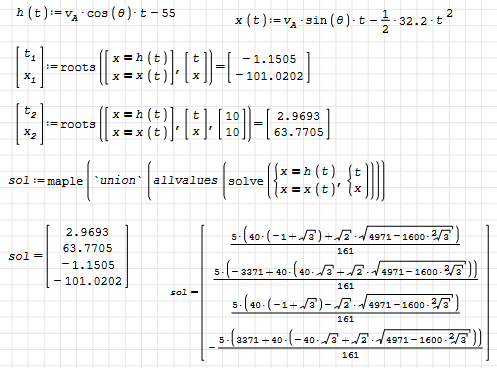

#2 Posted: 4/14/2023 5:35:21 PM
WroteI'm using the "roots" command, but I'm not getting the two points where the line intersects the parabola. The command gives me only one result and omits the other point. Attached is the file and image of the problem. How can I find both intersection points?
As doctored ... Jean
Roots Doctored.sm (9.38 KiB) downloaded 1402 time(s).

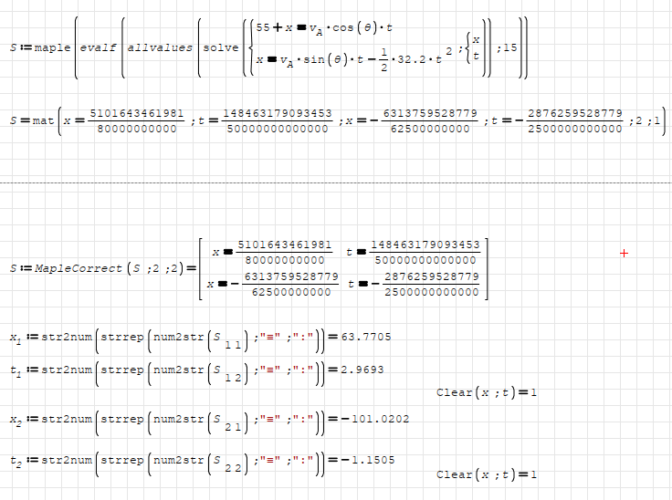

PS: MapleCorrect() function can be found here.
Assign() function can be used instead of str2num() + num2str() + strrep().
My personal favourite way to handle solver results is Davide's at() substitution function.
