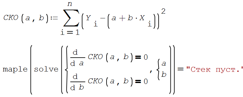

#1 Posted: 7/8/2023 12:36:53 PM
Valery Ochkov
Valery Ochkov
66 likes in 691 posts.
3-5.sm (3.97 KiB) downloaded 1199 time(s).
#2 Posted: 7/8/2023 1:01:36 PM
598 likes in 1,380 posts.
Derivatives mostly doesn't get along with solvers.
And you really need an n value to make this work.

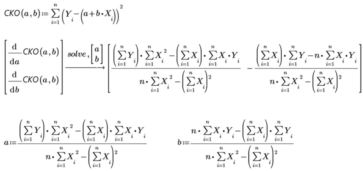

#3 Posted: 7/8/2023 1:10:17 PM
Valery Ochkov
Valery Ochkov
Thanks.
But I was waiting as in Mathcad

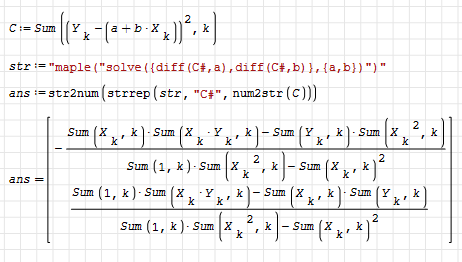

#4 Posted: 7/9/2023 1:42:37 AM
1,123 likes in 1,795 posts.
Hi. This is a way.
linregress.sm (17.05 KiB) downloaded 1198 time(s).
linregress.pdf (85.29 KiB) downloaded 928 time(s).

#6 Posted: 7/9/2023 4:47:30 AM
Thanks!
But what is it?
1 C:=Sum...
2 ans:=...
It's a maple component from the maple tools plugin. You must to have it at the insert menu:

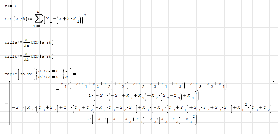

#7 Posted: 7/9/2023 11:18:19 PM
This is a way that avoids using the component and uses the maple function
