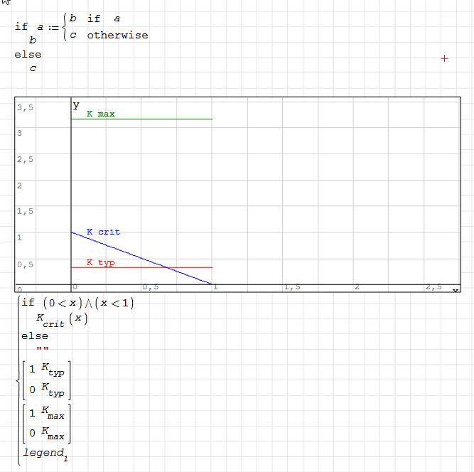

#4 Posted: 3/21/2022 6:30:37 PM
Would be interesting, why if() is not defined by default as boolean expression just like cases().
Is there any use case, where the original if() is better than the one defined with cases()? If not, then I propose to include re-definition of if() in the custom functions plugin.
![2022-03-21 22_18_08-SMath Solver - [SpecialPlotsBug.sm_].png](/en-US/files/Download/ZRkZwF/2022-03-21-22_18_08-SMath-Solver---[SpecialPlotsBug.sm_].png)

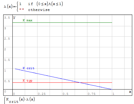

#5 Posted: 3/21/2022 8:20:41 PM
Bolean bug(s) are user bug.
Many projects will accommodate either style if/else ... if/otherwise
A long suite of conditions is horror if/else.
Doctor your plot 1 as proposed, press F9
Integrate Discontinuous_1.sm (24.57 KiB) downloaded 1636 time(s).

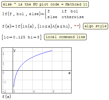

#8 Posted: 3/22/2022 9:26:54 AM
... doctored for convenience.
Observe collected plot, easy to manage.
Cheers ... Jean.
SpecialPlotsBug DOCTORED.sm (10.86 KiB) downloaded 1659 time(s).
