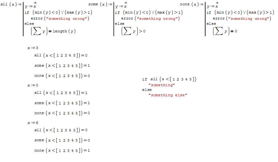

#7 Posted: 5/9/2022 11:25:27 AM
1 Pages (7 items)
![2022-05-09 13_37_05-SMath Solver - [some all none.sm_].png](/en-US/files/Download/zxmznX/2022-05-09-13_37_05-SMath-Solver---[some-all-none.sm_].png)
