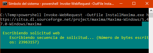

Hi Viacheslav. That could be an option, but I'm thinking in concise instructions using very basic system tools. For example, this is for download the last 32 bit maxima installation:
1. Open a windows command windows as administrator.
2. Go to some temporary directory
3. Execute this line
powershell Invoke-WebRequest -OutFile InstallMaxima.exe https://sitsa.dl.sourceforge.net/project/maxima/Maxima-Windows/5.47.0-Windows/maxima-5.47.0-win32.exe
4. Then silent install maxima in AppData\Roaming\SMath\extensions\plugins\MaximaDistribution with this
... etc

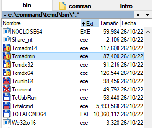

If a program needs administrator permissions it can request them. As far as I know, it doesn't have to be SMath, but the Maxima installation manager to do it
Thank you for the idea. I think I have successfully implemented silent installation by creating a PowerShell instance that runs the installation and subsequently requests administrative permissions. But for now I did it on a dummy program. I will implement it on maxima plugin soon.
