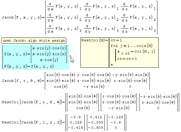

- Improve at function for handling v=P where v and P are vectors (see green comments in the attached)

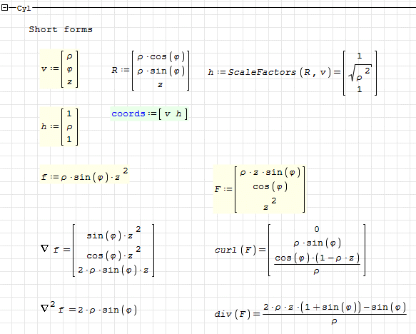

- In the attached, the 'library' style for the differentials applications, and help for get a large collection of coordinates systems, if in case that same one want to write the 'library'
coords v2.sm (110.26 KiB) downloaded 1066 time(s).

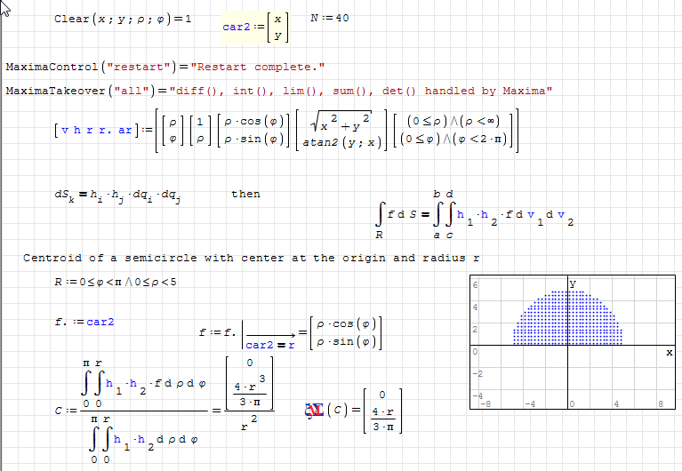

Polar integration in symbolic version:
Integral%20in%20polars_Kr.sm (57.53 KiB) downloaded 1172 time(s).
