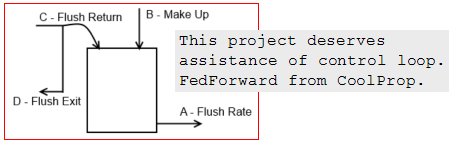

In my plant 20 pumps require flush water which is supplied by a close circuit water flow network. Flush rate & max temperature rise are per vendor specifications. Hot purge & simultaneous volume makeup by fresh water is what maintains the temperature.
I am attaching my solution to the problem. I further need to have multiple plots (on same graph) which corresponds to different temperature rises indicated by equation defining Tc. Please advice

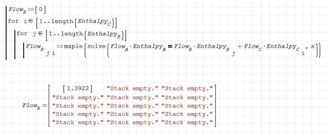

This should have worked ...the data dimensions are correct

I am waiting for a heat exchanger (with temperature loop) which will take x3 months. In the meantime I want to use make up water for temperature control by hot bleeding. Bleeded stream will not be wasted & goes to Cooling Tower makeup ...
Jean, can we use solve() command somehow?
#6 Posted: 2/20/2023 7:48:43 PM
Better wait the heat exchanger c/w control loop.
Detail: most likely the control algorithm will be Lead/Lag.
Your document is red. I will revisit.
In my native SS 6179, if CoolProp is used in another document
it can be called from another document ... a damned bug.
Cheers ... Jean.
#7 Posted: 2/20/2023 8:49:41 PM
No luck, your document is red with 1 page long error message.
You are trying to plot something, tabulate the data set.
From there, no problem to fit/solve.
Cheers ... Jean.
