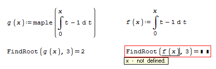

SMath solvers can't take an integral in the arguments, except al_nleqsolve.
netsonicyxf 7/16/2023 10:13:00 PM

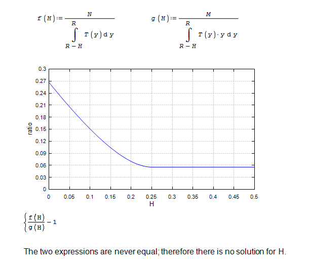

There are no roots!
mod: image link fixed; please use the forum attachment function (paperclip icon ) instead of external services
Worksheet4b.sm (18.29 KiB) downloaded 1375 time(s).
