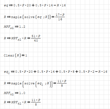

SMath Forum SMath Studio Questions Questions of solve function 1 Pages (2 items) Questions of solve function - Messages Go to last post #1 Posted: 8/30/2024 8:11:47 AM soomoon 1 likes in 39 posts. Group: User he first formula calculated well.The second formula did not calculate.The result is "The stack is empty."What is the problem?File not found.File not found. #2 Posted: 8/30/2024 9:18:59 AM overlord 582 likes in 1,349 posts. Group: Moderator Either clear R or use a different variable name, R.1 for example.Because you defined R at upper calculation, it confuses solvers.Regards 1 Pages (2 items) New Posts No New Posts
