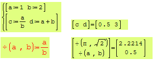

WroteIs there any way to present division on the same line and not as a fraction ?

Greetings!
It is possible to combine Davide's and Jean's solutions, but you need to pull off a few tricks:
1) Create a custom function with (1) parameter
2) Use the special inline division character 「÷」
3) Declare your custom function as a 'unit' (this suppress the multiplication operation from displaying)
To create the custom function with the inline division character, copy and paste the following into your SMath Worksheet:
To utilize it, type in your numerator and multiply it by the custom function, where you pass the denominator into the function as the parameter.
EXAMPLE: solving for 6/2; copy and paste the following (NOTE: since I am declaring the custom function as a unit; you must include ' when calling the custom function):
-Kenny Lemens, P.E.
Wrote...division on the same line...
'÷(_denom):1/_denom
6*'÷(2)=#@#
-Kenny Lemens, P.E.
