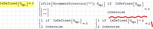

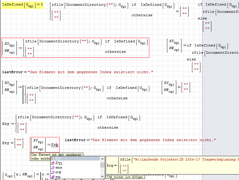

Hi!
I used the red bordered equation (and similar constructions) for a long time.
But this doesn't work no more.
Even if the result of the test is false, the true expression is evaluated, which fails in this example.
If/else does the job.
Assigning the equation to one variable works initially, but on second sight one can see, that the expression isn't really evaluated but only stored.
Is this all the intended behaviour? And why did it change?

With 0.99.72.51:
But now, the evaluation of the equation fails, even without assigning the result to a variable.
To me it looks like the result is the evaluated test clause.
With 0.99.68.84 it works.
