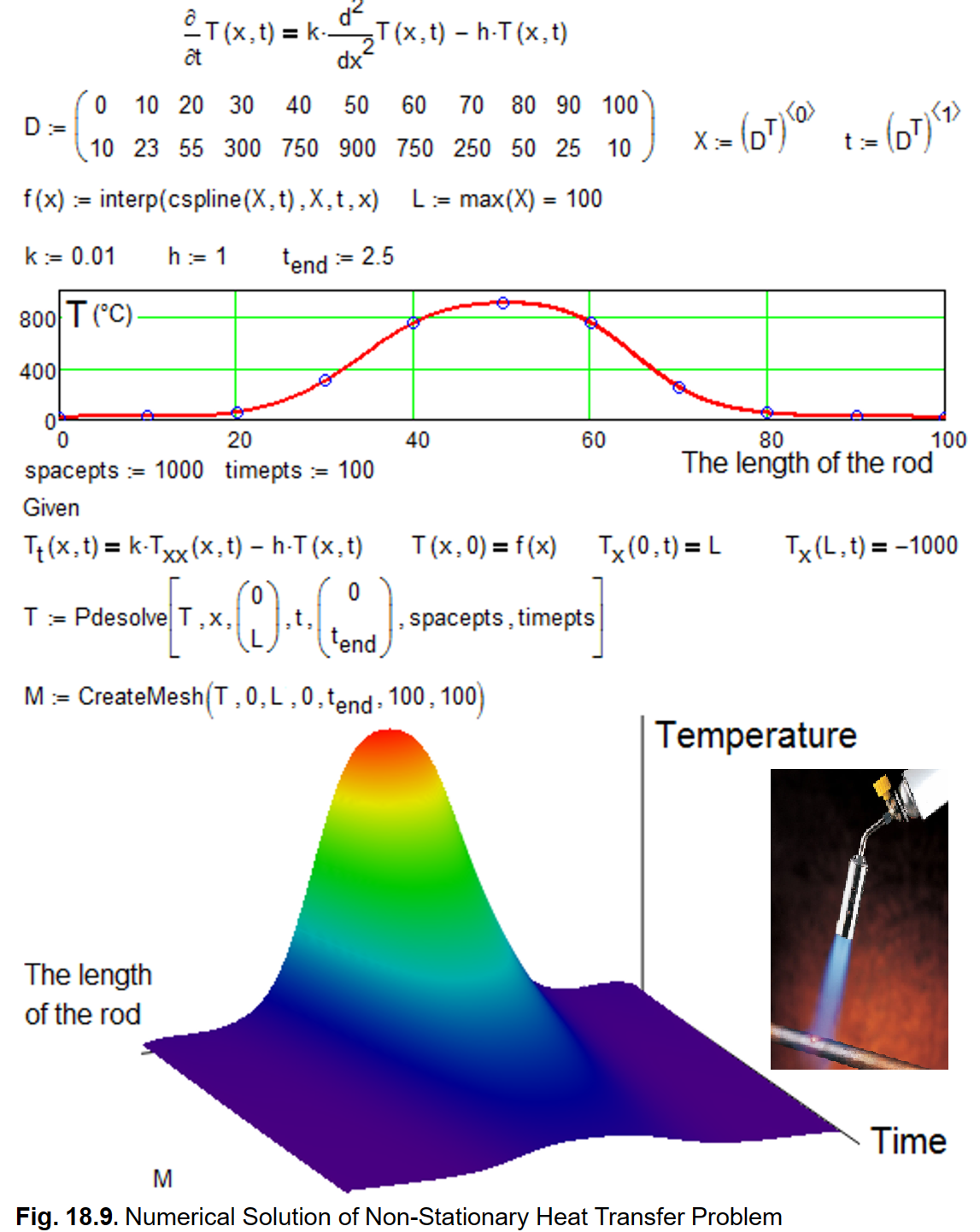

We heated the rod in the flame of a burner.
How will it cool down?
Non-stationary mode!
One stationary mode here https://en.smath.com/forum/yaf_postst23506_Cannot-plot-T-x--y.aspx

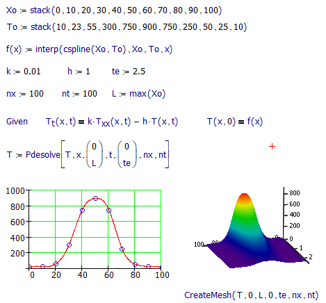

And what about the ICs?
We must use one numeric not symbolic method!

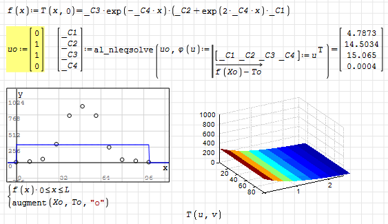

#7 Posted: 7/6/2023 2:33:10 PM
1,123 likes in 1,795 posts.
... And what about the ICs?
Using maple, you can try to use a maple "component" or a maple plot, which gives more flexible access to maple structured functions.
Also, there are some numerical procedures for pde's in Maxima.
Notice that in Mathcad the border conditions for δT(x,t)/δx are not considered for obtain the solution.
With SMath, you can try to adjust the curve choosing good guess values in the yellow vector.
pdesol_num.sm (14.78 KiB) downloaded 1249 time(s).
