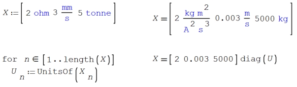

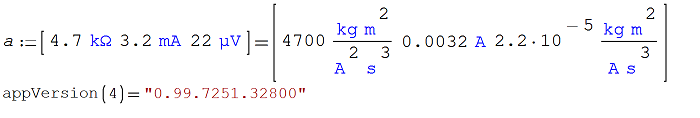

Units are not simplified (i.e. to ohms etc) from the base SI units, when they are in matrices.
This means that I can't really use a vector to return tuples from a function or display numbers with mixed units, as the units become unrecognisable.

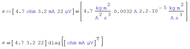

Hi. This is my workaround: in the unit placeholder put diag([unit1, unit2, unit3]^T)
sergio 8/25/2020 5:13:00 AM, Martin_B 8/25/2020 9:21:00 AM
