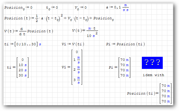

However, by analyzing the individual values
any solution?
#2 Posted: 8/16/2018 10:21:46 AM
127 likes in 342 posts.
You must use the "vectorize" function to execute the operation element by element of the vector "ti"

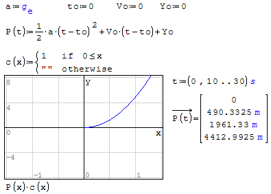

#5 Posted: 8/16/2018 1:42:30 PM
Cannonball project ...
Maths Cannonball Copy.sm (28.19 KiB) downloaded 1105 time(s).
sergio 8/16/2018 1:46:00 PM
