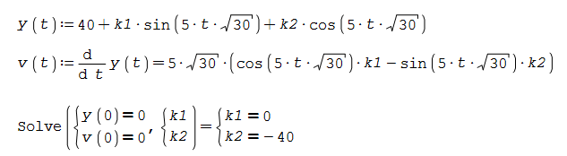

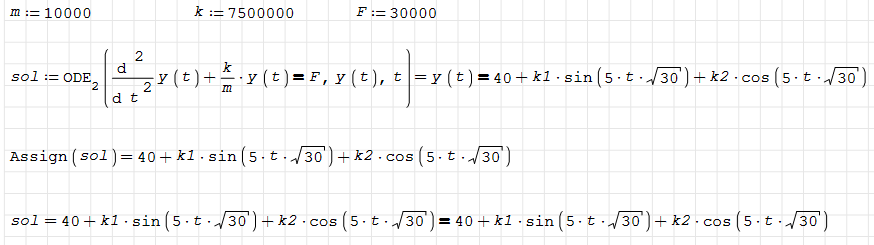

SMath Forum SMath Studio Questions How to apply initial conditions in second-order differential equations 1 Pages (3 items) How to apply initial conditions in second-order differential equations - How to apply initial conditions in second-order differential equations - Messages Go to last post #1 Posted: 12/7/2025 3:59:55 AM kimkim 0 likes in 9 posts. Group: User How to apply initial conditions in second-order differential equationsThe solution to the second-order differential equation has been obtained as follows.If we want to find the solution by applying the initial conditions y(t)=0, y'(t)=0,what should I do in the following steps?thank you for your help. Edited 12/7/2025 6:53:24 AM #2 Posted: 12/7/2025 9:07:00 AM StvMath 43 likes and 1 dislikes in 68 posts. Group: User Once you've got y(t) you could simply do the following: 1 users liked this postkimkim 12/7/2025 9:41:13 PM #3 Posted: 12/7/2025 12:54:45 PM Martin Kraska 1,311 likes in 2,228 posts. Group: Moderator If you don't need the function v(t), you can specify the initial conditions directly: (example 10.2 in https://github.com/sn-code-inside/Technische-Mechanik-mit-SMath) Martin KraskaPre-configured portable distribution of SMath Studio: https://en.smath.info/wiki/SMath%20with%20Plugins.ashx 3 users liked this postsergio 12/7/2025 5:07:45 PM, kimkim 12/7/2025 9:41:18 PM, ioan92 12/9/2025 10:52:27 AM 1 Pages (3 items) New Posts No New Posts
