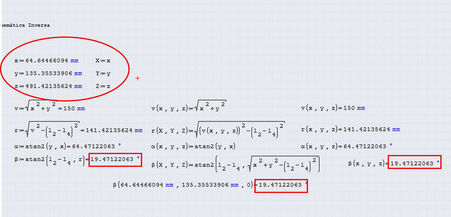

Hi, I am having some issues Here,
As my english is very bad, I prefer to show you the picture about my problem
If I make step by step caculations, the answer is correct (Which is 19.47°). When I try to make them using user functions, the answer is wrong even if I am using the same values for parameters.

This is a bug.
The problem is triggered by your naming. You use x, y throughout your functions. It seems that actual parameters names interference with dummy parameters names. Here it's evident: arguments-bug.sm (2.61 KiB) downloaded 1220 time(s).
To workaround, please change names of parameters in your functions, namely in atan2. E.g., you may make it atan2(yy;xx):= ....
Created SS-2327.

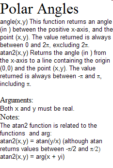

Your coding is not correct:
"atan2(x,y) => returns the angle in radian from the 'x' axis to a line
containing the ORIGIN [0,0] and the point [x,y]. The value returned is
always between -π and π including π. Both x,y must be real".

#6 Posted: 4/22/2016 11:49:19 PM

"Universal Implementation" of atan2 is as adopted since the very first day of FORTRAN,
respected in Mathcad 8/11 but not in your Smath version.
