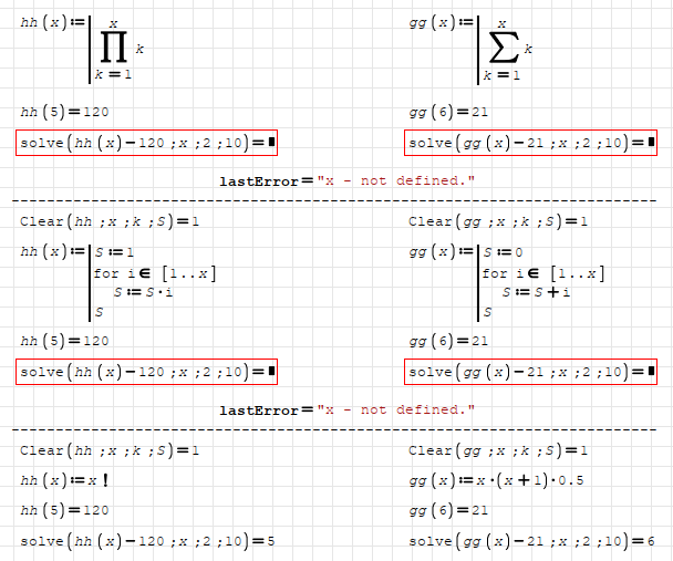

#4 Posted: 3/29/2022 4:24:05 PM
Augmented version ... no red SS 6179
If you don't see or have red the 3 blocks,
please let me know for a snippet image.
Cheers ... Jean.
