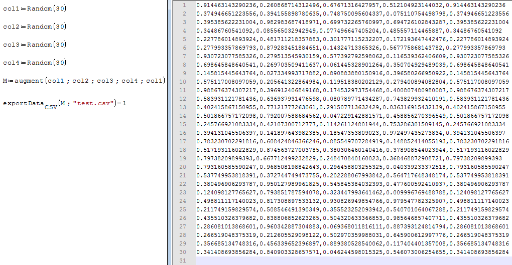

#2 Posted: 3/29/2017 7:48:02 AM
#3 Posted: 3/29/2017 12:58:37 PM
WroteFor that, I use a matrix to which I add the columns one by one
Give some hint about your matrix:
1. created in Smath as an 2D image ?
2. columns from foreign source or from Smath modules ?
If foreign from source as individual columns
easy to augment via a little piece of program.

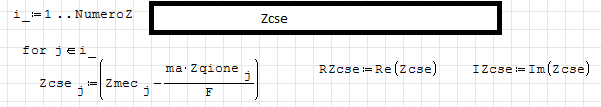

It is created via a succession of augment() of columns made of real and imaginary parts of complex arrays that are created line by line in a for loop, example for one of them here:
Giving you the .sm file would be complicated because of the plenty of files it opens...

#6 Posted: 3/31/2017 6:57:12 PM
WroteIf I remove the " " and try to read it with rfile it gives the value 0.
Your collection is not a matrix; it is an MDA [Multi Dimensional Array => Matlab]
or a CELL ARRAY [Mathematica]. No matter, the "collection" can be spooled to file
and recalled from file, just do it the right way as exemplified [attached].
File Create.sm (24.67 KiB) downloaded 1131 time(s).
... you can't remove the quotes "..."
