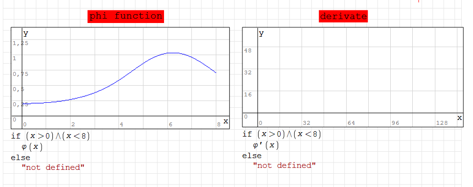

Hello everybody.
I can't understand why the phi function does not compare in the graph.
This function is the derivative of the phi function that instead appears in the graph.
Someone could help me please?
Thanks in advance

WroteI can't understand why the phi function does not compare in the graph.
1. your φ(t) plots correct
2. The Smath derivative operator works on derivative rules.
3. The φ(t) is too much a monkey business for derivative rules.
4. Rescue via transit infinitesimal analysis.
5. Your constrain in plot argument is obsolete since if/otherwise
was introduced by Davide from f(x) menu "cases".
