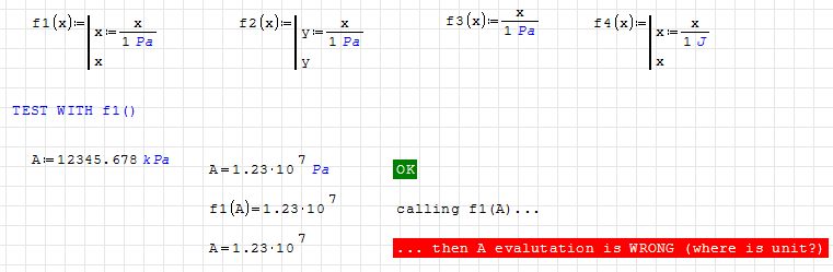

Hi
someone can confirm this issue?
seem that:
- it's not related with optimization
- appears only when you redefine an internal variable inside a line() in a user-function, making them dimensionless
best regards,
w3b5urf3r
#2 Posted: 7/9/2012 6:13:45 AM
Hello w3b5urf3r,
This is related to changing the function arguments. As your function is defined as f1(x) and you actually change x then if you call your function with f1(A) then A will change as well. Your function f4(x) actually changed its argument too.
Davide Carpi 7/10/2012 12:55:00 PM
#3 Posted: 7/10/2012 12:34:34 PM
1,443 likes in 2,936 posts.
Hello w3b5urf3r,
Hi Omorr
you're right, f4(x) cause the same issue...
I don't know if it's a bug or a feature, but it's quite strange for me... In my mind I think that
the input variable should not be modified, unless the change it's invoked directly (A:=something)
best regards,
w3b5urf3r

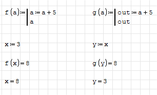

I think that the image below could be useful to explain the behavior
Using f(a) the input variable - x, will be modified by the function;
Using g(a) the input variable - y, doesn't change.
regards,
w3b5urf3r
