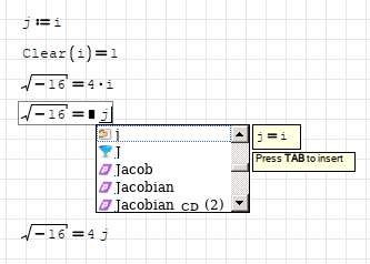

However, you can assign sqrt(-1) or i to j.
Results placeholder can be edited with j.
And you can reassign you i result to j.

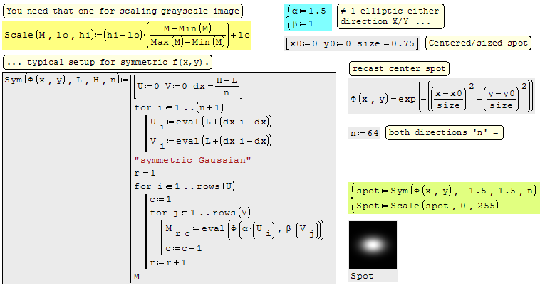

As well, 'i,j' are largely used by Smath original Designers
and the Smath Community as rows/cols indices.

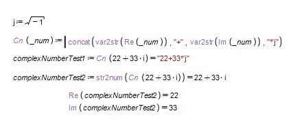

First: define 'j as the imaginary unit; copy and paste the following:
Quote
'j:sqrt(-1)
Next: define a function, similiar to this:
Cn(_num):line(concat(var2str(Re(_num)),"\002B\",var2str(Im(_num)),"\002A\\0027\j",1,1)
With this defined at the top of your sheet, you can display your number (as a string) in the syntax you desire. To use it as a mathematical expression, just use the str2num() function to convert it into math. NOTE: for this to 'work,' you need to have the 'Custom Functions' plugin installed:
May this be of Good Help!
