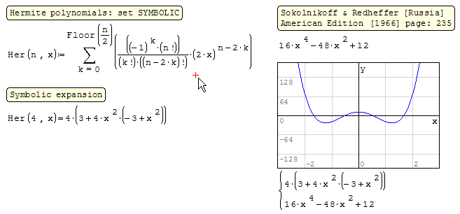

Smath does not "floor" n/2 in Hermite.
You can force: Floor(n/2)
Maths Schrodinger.sm (26.94 KiB) downloaded 1544 time(s).

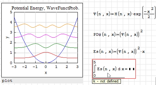

#4 Posted: 10/3/2016 5:48:05 PM
WroteIntegration error in 98.6103??
I've checked it.
The reason is that 0^0 is undefined in latest versions of SMath Studio.
So when program tries to calculate integral of initial equation, it has to calculate (2*x)^{n-k}, where x=0, n=4 and k=4.
That is why error occurred. Will think what can be done here.
Regards.

#6 Posted: 10/4/2016 4:09:13 PM
WrotePlease take note of another side of this problem
Good approach in theory, but not applicable in real life (at least in current real life
0^0 error happens on sum() function processing and not actually means anything for int() who initiated calculation. int() decides that its body cannot be calculated on first attempt and simply eats exception to return int() itself (with all its body) for further actions. But the next action is numeric calculation, which proceeded by numeric engine which knows nothing about summation and integration, so it just stumbles on the first undefined variable (k) and throws this error to user.
You'll say "bad design"? Yes, most likely. But it cannot be fixed fast and simple... unfortunately.
Regards.
#7 Posted: 10/4/2016 10:05:12 PM
I understand what you are saying Mike about error messages not chaining
from the first error code. On that, Mathcad/Mathsoft was slightly better.
Often, in Smath 5346, going upward goes right to the error code.
The Hermite formula is totally correct. Here the sanity with my bible.
What's lovely with Smath 5346, at opening a work sheet it defaults to
symbolic. Thus, compose the formula, up it plots and resumes the
remaining of the project.
#8 Posted: 10/5/2016 1:23:44 AM
... there is more on that: Hermite/Hermite & Hemite/Rodrigues.
Attached: bits and pieces.
Polynomial Hermite.sm (18.47 KiB) downloaded 1474 time(s).
#9 Posted: 10/5/2016 11:59:46 AM
Fixed.
