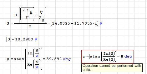

SMath Forum SMath Studio Questions Units: Operation cannot be performed 1 Pages (5 items) Units: Operation cannot be performed - Messages Go to last post #1 Posted: 5/18/2016 4:50:08 PM Basile 8 likes in 172 posts. Group: User Any solution to this units problem?Thanks,Basile #2 Posted: 5/18/2016 7:04:41 PM Andrey Ivashov 2,335 likes in 4,034 posts. Group: Super Administrator Thank you, Basile.I've corrected Im/Re functions to support units. Will be available in the next nightly build.Best regards. 2 users liked this postDavide Carpi 5/18/2016 7:13:00 PM, Basile 5/18/2016 11:07:00 PM #3 Posted: 5/18/2016 8:57:56 PM Jean Giraud 983 likes in 6,866 posts. Group: User Use the function arg(complex) #4 Posted: 5/18/2016 11:10:17 PM Basile 8 likes in 172 posts. Group: User Andrey and Jean,Thank you very much,Basile #5 Posted: 6/5/2016 1:59:35 PM Basile 8 likes in 172 posts. Group: User Andrey,It looks that it still in the xy2polBasile 1 Pages (5 items) New Posts No New Posts
