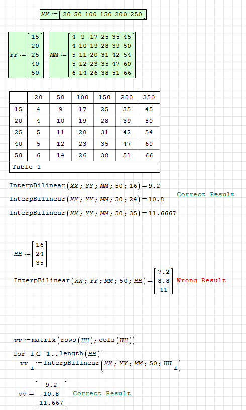

First of all I don't know if this method is supported, it would be very useful if not.
So if this is not a feature please forgive me because I considered as a bug.
The "InterBilinear" function gives wrong results if matrix is used for x or y value.
interpolation.sm (15.61 KiB) downloaded 1358 time(s).

It is a bug, thank you! 4th and 5th argument type isn't checked, therefore (unintentionally) vector math applies.

#8 Posted: 7/5/2019 1:31:12 PM
Two things here:
InterpBilinear(vx,vy,M,object,vector) ... does not collect"vector wise"
InterpBilinear(vx,vy,M,object,valueX) ... correct
That is the answer to the "bug",
