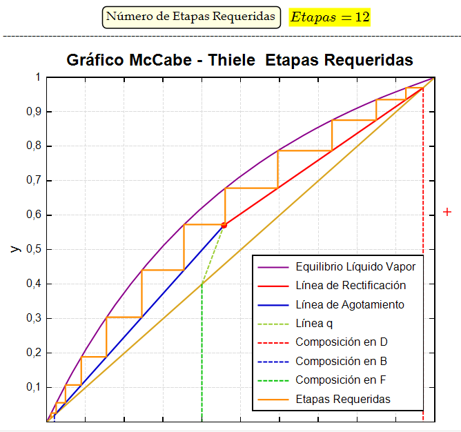

Hello friends, this time I want to share in this great and warm community of Smath Studio, a worksheet that calculates the required stages, minimum stages and minimum reflux ratio for a constant pressure binary distillation.
This document is corrected, and highlights a database of 700 organic compounds, the calculation of 6 graphs, mass balances, compositions, pressures and temperatures. The calculation time is 1 to 3 seconds.
I hope it will be very useful for students of Chemical and Process Engineering.
* it was decided to carry out the worksheet in this way, since if the compositions, temperatures and pressures that appear on pages 18 and 19 had been calculated differently, the calculation time would be 3 to 7 minutes.

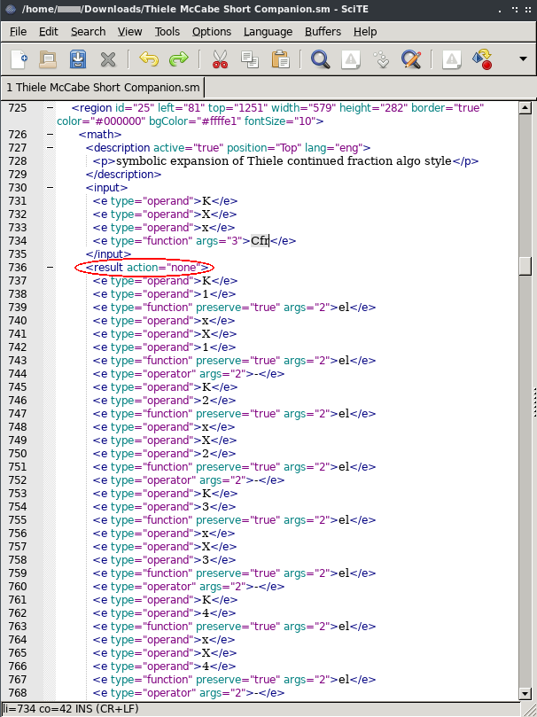

#8 Posted: 12/9/2020 6:39:24 PM
600 likes in 1,381 posts.
You are quite right, very many declare bugs from wrong doing.
However that does not happen from Smath Power Users [Leslie expression].
Everybody make mistakes.
Actually there is no bug in new builds about this issue.
I had checked your file with a notepad.
Your Cfr equation has the result segment in it.
New builds read it correctly.
It seems the bug is in previous builds.
The Cfr equation is not a definition as it seems in your file.
It has a result action, because you had wrote it as a result.
This is why new versions couldn't parse and calculate it.
This is the correct way, a result shouldn't be considered as a definition.
However, very old versions (build 6179 in this case) read it as a definition.
Which they shouldn't, this is a serious bug for old builds.
Fortunately now we are far from that bug thanks to mods.
They had patched it years ago I guess.
Regards.

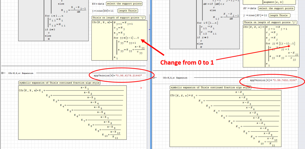

#9 Posted: 12/9/2020 9:22:56 PM
CBG
CBG
78 likes in 312 posts.
Jean's file does not contain any errors, but simply that the new version cannot handle the ZERO subscript. Changing the subscript ZERO to 1, the file runs perfectly.
Carlos
Thiele McCabe Companion MERITAS_V7632.sm (77.48 KiB) downloaded 1663 time(s).

#13 Posted: 12/10/2020 5:04:26 PM
Than that is another bug of older builds.
For function shouldn't read the zero element of vector or matrix. Calculation has to give an error. This is how smath handles arrays now as far as I know.
Someone couldn't write an equation as in the pictures above with an equal sign also, but he did somehow. You must use definition.
As I said before, maybe Jean's document is right when it was written and somehow it was working. But it shouldn't, it was working because of bugs (or loopholes). This kind of behaviors was considered as bug by developers and not working now.
What I am saying, these are not bugs of new builds. These are bugs or loopholes of older builds.
Under most applications, 0 indexing was an error in older SS version.
For the case in cause it was not, but latest didn't recognized.
Put yourself in the shoes of Clients ... F..k Smath with so many sudden build.
The attached should reconciliate. If You have red, make sure to evidence the red.
The = that puzzles you is the symbolic expansion, not a forgotten :=
About symbolic expansion, in at least one instance, Smath does not save settings
and re-opens red. In that case, yes you have to redefine/assign.
Indexing '0' is logical, considering that all numerical approximation of functions
are on the range [0 ..1]. Even in Mathcad, not so easy sometimes to ORIGIN 1.
