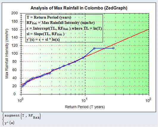

Can we have graphs of data
Linear - Linear, [Yes]
Linear-Log, ?
Log-Log, ?
Thank you,
Basile

I also tried semi-log using X-Y Plot, but could not find a way.
However, it is possible using ZedGraph plugin.
Davide Carpi 1/18/2017 10:33:00 AM, frapuano 2/18/2018 8:47:00 AM

I don't catch "ndtma" plot, it looks to me a "qq plot".
This type of plot is on linear/linear. log scale is a
means to visualise globally large range of values.
You could probably manage your demand inspired from
the "logpts" attached.
Utilities logpts.sm (42.29 KiB) downloaded 1254 time(s).
