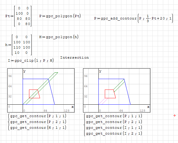

In regards to hatch and fill - do we have a Smath code that can hatch a closed polygon?

Hello Alex,
We don't have it yet for the closed polygon.

#33 Posted: 3/29/2017 9:58:50 AM
1,356 likes in 2,271 posts.
Try the gpc wrapper plugin by davide
GPC.sm (6.8 KiB) downloaded 1741 time(s).
