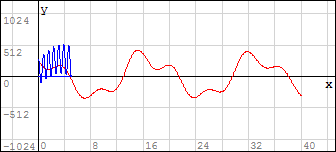

Hello SMATH Collaboratory,
Attempting to transfer a worksheet from MC Prime to SMATH. Couldn't get page 3 of my SMATH sheet to augment the x & y data for the graph; I tried a few variations , yet unsuccessful. I welcome any input(s)/recommendation(s).

Hi Nasch. This is an option.
Review of System Transients.sm (158.95 KiB) downloaded 1207 time(s).

#4 Posted: 1/19/2023 12:11:52 PM
Here's the updated worksheet.
Review of System Transients.sm (197.75 KiB) downloaded 1177 time(s).
The graphs differ some from the MC version, also some added data/lines in the graphs are exhibited.

#5 Posted: 1/19/2023 1:50:20 PM
Ah-h! I tweaked the 1st line under the "for" loop and the graphs are better.

#6 Posted: 1/19/2023 2:07:12 PM
WroteThe graphs differ some from the MC version, also some added data/lines in the graphs are exhibited.
Something like this ?
Review of System Transients (2).sm (280.61 KiB) downloaded 1198 time(s).
#7 Posted: 1/19/2023 2:38:46 PM
Hi Norm. This version returns the same plots. Initials conditions in yellow.
Review of System Transients.sm (233.04 KiB) downloaded 1219 time(s).
