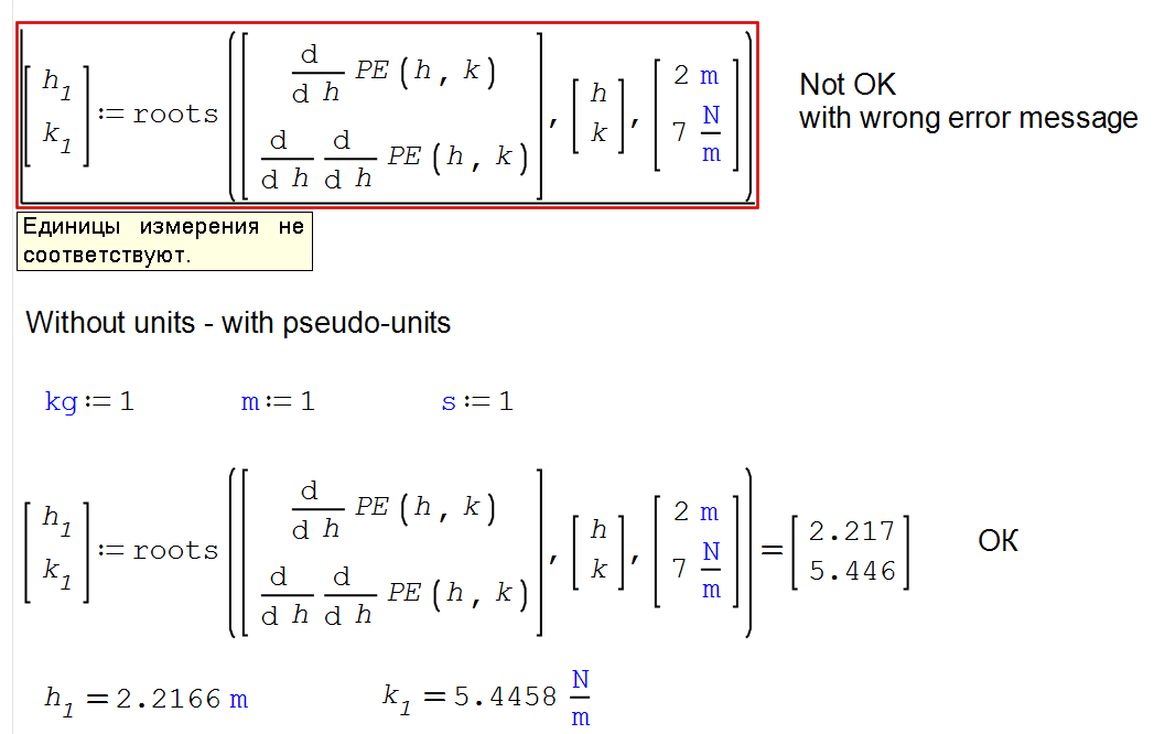

Can Roots and Solve functions work with units?
See please the attach!2-4-OOO-Plots-DD.sm (14.94 KiB) downloaded 1447 time(s).

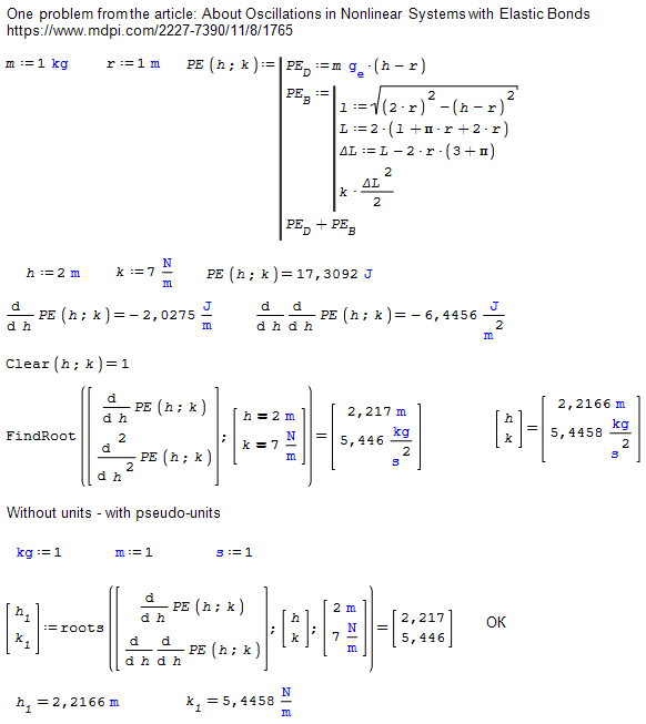

There are several ways to handle units with SMath roots. This is one of them, where the units are sterilized (Pompelmo' dixit) locally, instead of globally.

Thank you, but this is very difficult for me.
The question was simple: Roots & Units.

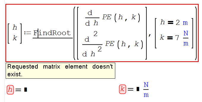

It is simple, if you use Findroot()
2-4-OOO-Plots-DD_Kr.sm (16.37 KiB) downloaded 1411 time(s).

Why?
#9 Posted: 5/20/2023 7:29:49 PM
Why ?... Not coded as per the plugin instruction code.

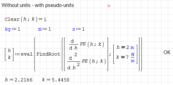

Use eval(), sometimes it resolves problems.
Especially it is useful on some solver situations.
