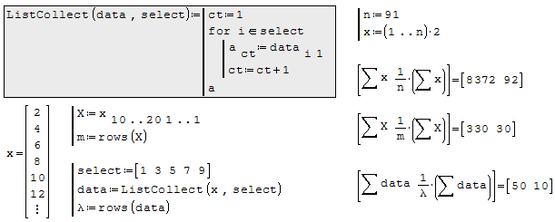

Hello.
This may be helpful.
Summation EX.sm (214.79 KiB) downloaded 1150 time(s).
