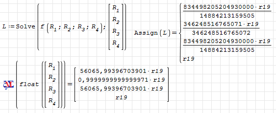

Solve() from the Maxima plugin can handle under-determined systems of equations. In such cases, the solution contains a free variable. The name changes every time the sheet is recalculated. If you want to rely on that name, insert a MaximaControl("restart" ) command to reset the Maxima session and the counter.
![2023-11-25 16_32_27-SMath Solver - [Trial.sm_].png](/en-US/files/Download/es37xF/2023-11-25-16_32_27-SMath-Solver---[Trial.sm_].png)
Trial_Kr.sm (41.8 KiB) downloaded 1521 time(s).

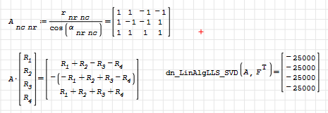

Hi. Can you share the Mathcad result? This page is the help for matlab techniques for handling underdetermined systems: https://www.mathworks.com/help/matlab/math/systems-of-linear-equations.html#bt7ov7u
Writing the system as a linear one, SMath have some functions for work with those systems, like this one
Trial.sm (61.84 KiB) downloaded 1415 time(s).
